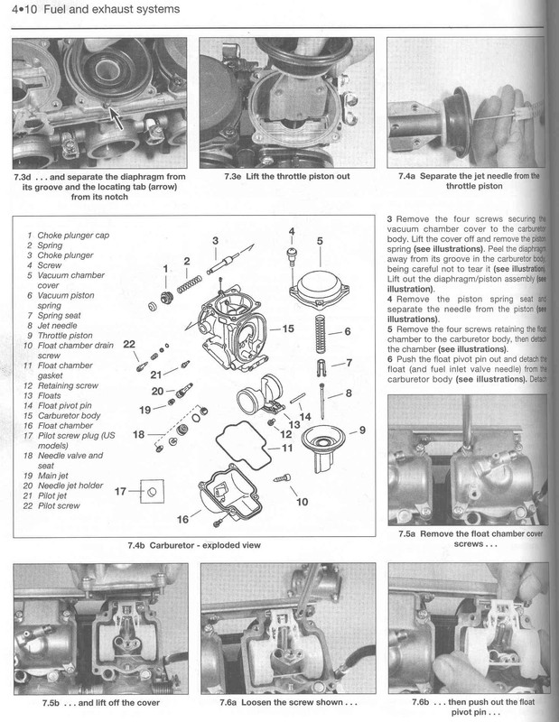

          Just curious... when I opened the carburetors up, I unscrewed one jet and the other brass fitting I unscrewed was just a cover over a jet, but I didn't know how to remove them. So I sprayed it with the cleaner. Anyone take apart the Zzr600 '08? I'm being specific cause maybe the other year models can differ.

            The jet that is uncovered, I don't know how to remove that. Any suggestions?

              If you are talking about a jet that is recessed down inside the tube, it takes either some luck with a screwdriver that is too small, or a special or modified screwdriver that fits the bore of the tube. Otherwise, you can chew up the jet and have real problems getting it out.

                  Thank you. I used a toothbrush and scrubbed it as I sprayed that jet. I noticed it didn't have the tiny hole at the end like the slow jet. It just had 3 pairs of tiny holes along the side of it.

                    I had a look at the parts fiche for your model and it shows a #12.5 pilot jet, which is a a small jet and could clog easily. It is difficult to see the detail in the fiche, but it looks like the jet is a push fit?
                    If you haven't done so, a new fuel filter would be worthwhile.

                      Needle jet?
                      They are usually a push fit.

                        It won't be the needle jet - that is fed by the main jet. If you remove the extension that the main jet screws into, then you should see the needle jet.

                          I change the fuel filter the first go round. I am assuming the left over gunk may have trickled in from the hoses after the fuel filter. That's the only thing I haven't changed. In the top picture I posted, the cavity without anything is where one pilot jet was. I unscrewed it out. The brass to the left was the other jet, which was covered with a cap (you can see in the bottom picture). Is that what you described as a push fit?

                            Ah, I didn't realise that you'd already removed the pilot jet, although I was puzzled why there wasn't anything in that hole!
                            The brass piece is not a jet, it's the tube to the needle jet. It looks like there is some kind of screen at the tip. That is probably a push fit as it doesn't look like it unscrews.
                            You shouldn't need to clean the needle jet.
                            Were the pilot jets clean?
